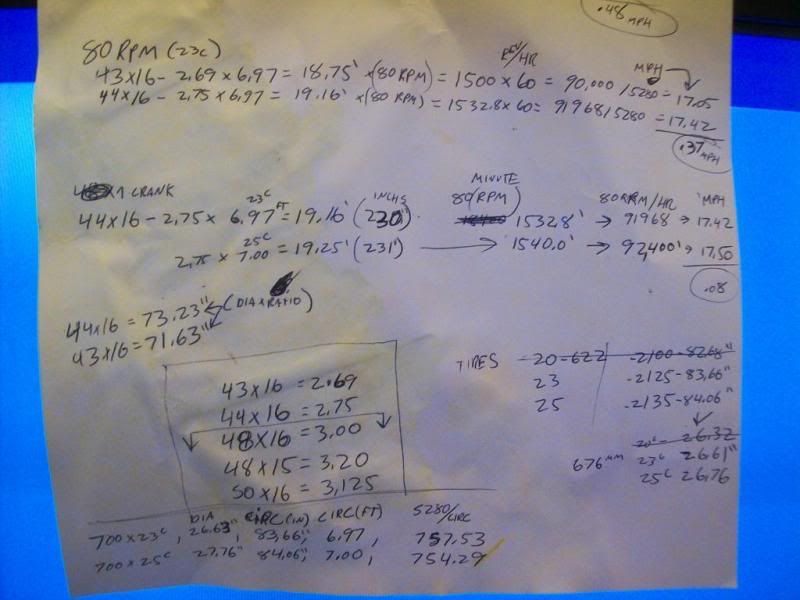

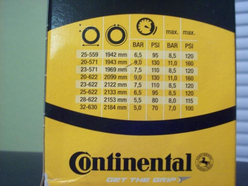

    Quote Originally Posted by Kerry Irons
    Short of claiming that 25 mm tires are made that way by adding 2 mm more tread thickness to a 23 mm tire, could you please offer any plausible explanation of how a basically round structure (the tire will go to a round shape anchored by the rim sidewalls) could be taller and not wider? I think you are seriously confused.
    It might offer an answer.
    One day I was bored so I figure the difference between using a 23c and 25c tire.
    What does a 2mm difference make with 44x16 @ 80RPM? The 25c tire averages .08 Mph more, almost 1/10 Mph more with the same gear and cadence. Now I'm not saying 25c tire are faster, you will have to compensate for the larger wheel diameter.
    I'm going to guess in real life . . . rather than paper . . . the two are almost indistinguishable.
