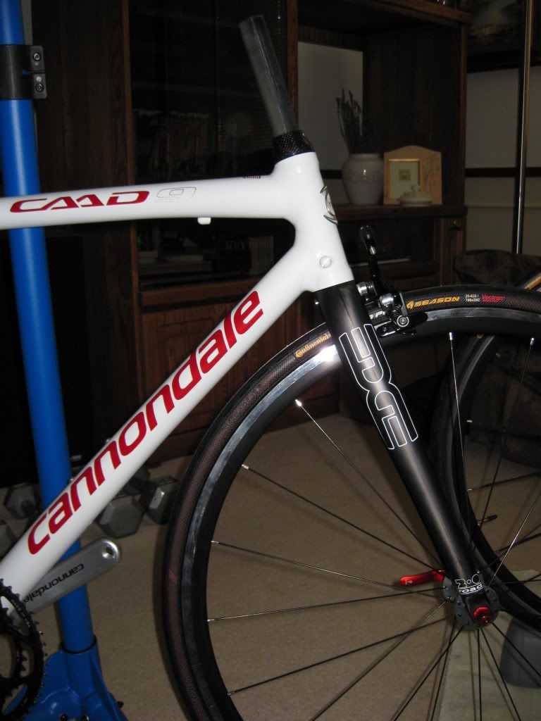

    I figured I should throw this in here just in case anyone is confused about WHY I feel the fork must be alterred. I believe the image speaks for itself...
    I am actually thinking we'll probably end up just going solid white, as I already have all of the paint and supplies to get that done - my friend just has to get the right gun out of storage to do the paint. I'll keep you guys posted...
