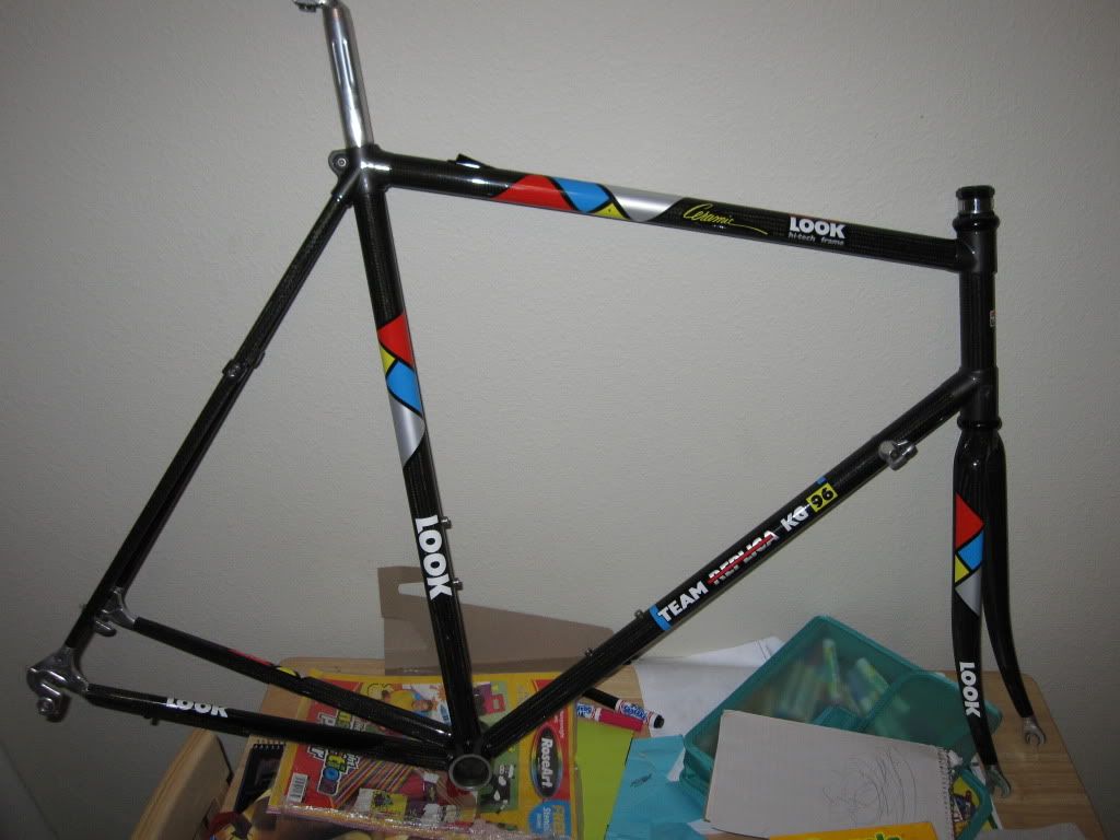

    Would an old lugged design be a worthwhile build up? I'm looking for a lightweight carbon fiber frame for a build project and a quick search on eBay found this. What do you guys think a frame like this is worth?

    Elmira > Taiwan > Elmira
    Nov 2005
    680
    Quote Originally Posted by -Boat- View Post
    I can't post the link (post count) but here's the item number...
    300673154140
    Note what the entry said:
    "I'm sure it will make someone a very nice vintage road bike project."
