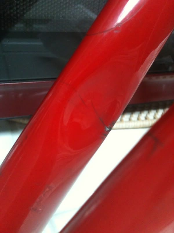

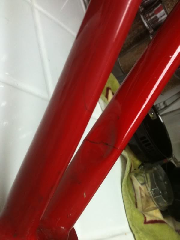

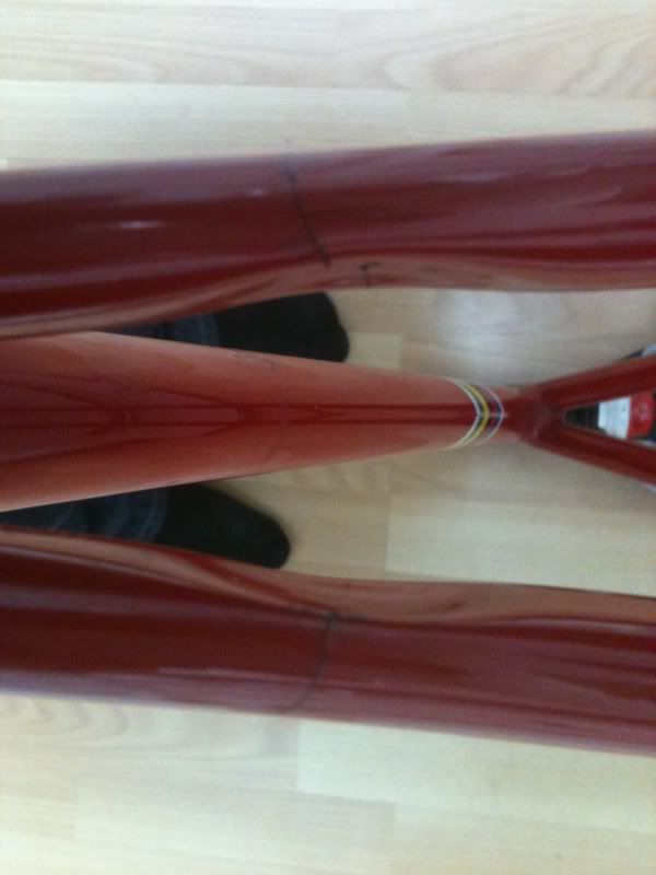

    Just wanted to post up my experience with my 2003 Masi Vincere. The bike had never been raced or crashed. This bike had been an absolute blast to ride and I am very said to part ways. This has served as my commuter bike and has been very reliable with it's 9-speed Shimano groupo. A couple of weeks ago I developed a squeak that I thought was coming from the BB area. The squeak was only when I was out of the saddle, pedaling hard. I tried snugging up the BB, cranks, chain rings, pedals, etc., etc. with no luck. Tried opening up both brakes to see if the noise would go away, no luck. About to give up I flipped the bike over to inspect further to find cracks on both chain stays. The cracks formed on the dimples/crimps that were intended to give more clearance for tires. The cracks were allowing the frame to flex enough to allow the tire to rub on both chain stays. Scary to think that two days before I was riding the Como street ride in a pack of 50+ reaching speeds of 40+ mph.
    I contacted the Masi warranty department explaining my issue. Upon further research I found threads with other Masi owners having the same problem. One guy's bike even "broke in half" at the same spot. A Masi employee had responded about the defective chain stays here (for the same model and year of my frame):
