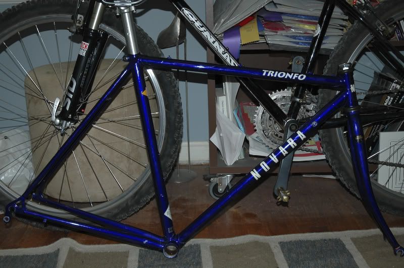

    Also all of the Gunner/Waterford talk is nice to hear. This is a pic of the Tange frame that I am talking about in my original post. Take a look at what I am riding in the background. I know it isn’t a road bike but it is what got me back into riding.
    PS please excuse the dirty floor, its drywall dust from remodeling.

    It would be nice to know who actually made the frame.......Panasonic? It looks great and just my size. Let me know if you want to move it. A new paint job would and a custom decal job would go a long way in making this frame a real gem. Not that it is not one already.
    BTW, that bike was not made with Prestige tubing, err, Prestige yes, but it was actually made from "Presitge Ultimate"....an even more refined tube set. Lighter and thinner tubed than the already very nice Prestige tube set. It should work out perfectly on a 50cm size frame. You got yourself a very nice frame. Try buying that new today and it would cost you some long green.......not that anyone would pay long green for your frame......but it is worth it.
