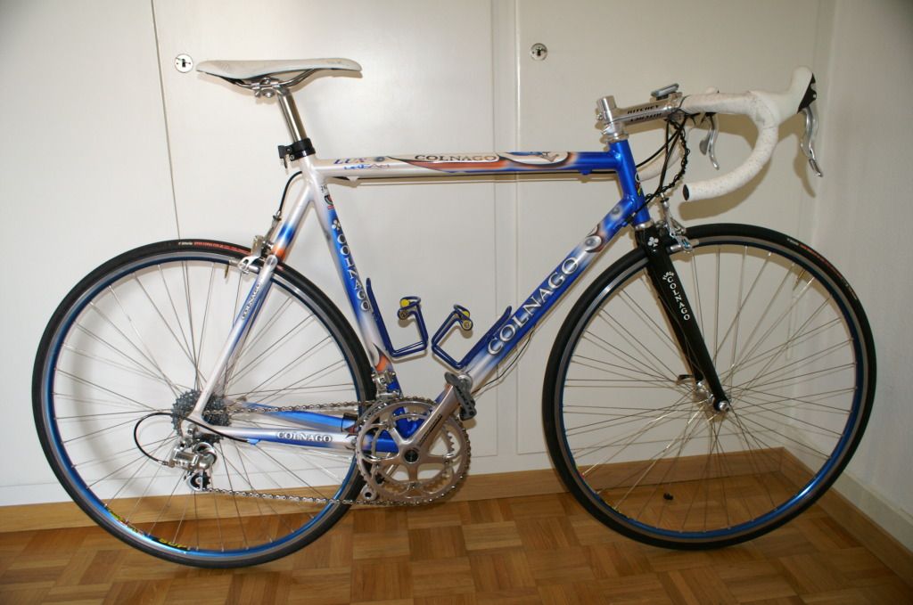

    Fortunately I stashed a full silver 2009 Centaur Ultra Torque/Shift groupset. ( plus a set of shifters I have in my parts inventory )
    It is build in the moment on my Colnago Dream while I wait for my Master 30th.
    The full group will be transferred to the Master, including the bottle cages and wheels, then this Dream will be rebuilt on full Dura Ace 9 and put for sale.

    Holy Italian bike pron !
    Judging by the HT, the I'm guessing the frame is a 55cm or 56cm. How close am I?

    Shifter Lever Swap
    57cm
    I like it a lot but I think a Master is what will be my perfect retro all-metal bike
    I ride a 56 and this one is just a little big
    Notice that older Colnagos have a little shorter HT, this one has the same HT as my 56cm C50
