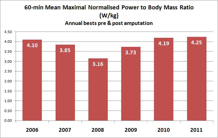

    Quote Originally Posted by kbiker3111 View Post
    Here's my question: I've been battle problems with my left leg all year. Now after surgery and weeks on crutches, I'm beginning recovery and strengthening my leg. I have access to a Computrainer and it would be nice to have a metric to gauge recovery at PT other than how much my knee hurts. What is the relevant information that can be learned from spin scan and how should I setup a test for it?
    If you have two legs, then all that matters is two legged power, so focus on that.

    Quote Originally Posted by Alex_Simmons/RST View Post
    In 2007 I had a lower left leg amputation. This was my progress:
    I've seen your chart before and I agree that cycling performance has little to do with leg balance (although that chart is n=1). What I'm asking is more overall health oriented. Assuming I was pretty close to equal leg strength pre-injury I'd like to have a way of measuring how well I'm recovering. It seems the majority of coaches agree that spin scan is a misused tool with results that are often misinterpreted. What are people interpreting wrong? Is it simply the leg balance == performance fallacy? Can anything useful be learned from spin scan? If so, what is the proper test to do?
