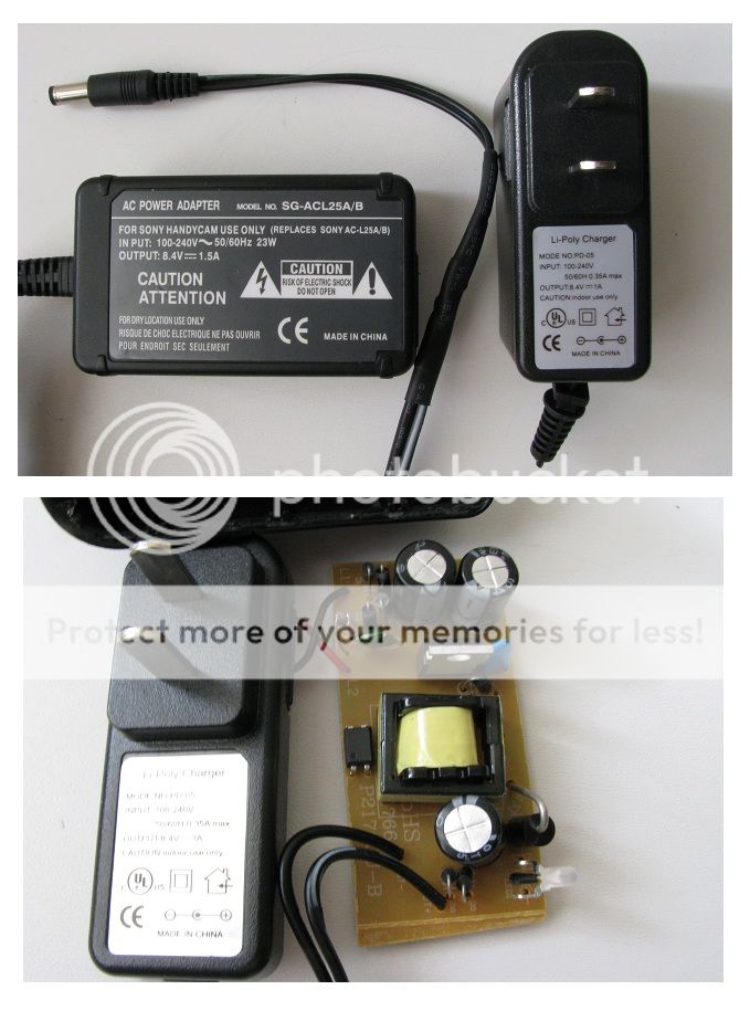

    I was hoping this lamp would problem free a little longer but since my original review I've run into some issues.
    I switched on the light during a night ride and it ran for about a minute then it shut off. It seems like the battery just ran out of juice.
    I plugged it into the charger and the LED indicator light was out. So I left it over night but it didn't charge the battery. I put a meter on it and the charger has died.
    I've order a replacement charger.
    I recieved a Sony laptop charger @ 8.4V 1.5A. Pretty close to the specs. of the original charger. I spliced the jack from the broken adapter, soldered and heat shrunk the splice.
    Put the battery in a metal tray and plugged in the charger. I monitored the temperature the entire time. The adapter was slightly warm and the batteries showed no signs of heat. After 5hrs it was done. The adapter was cold.
    Plugged in the light. Bingo! Back to night riding.
    The old adapter just died. Other then no LED there was no other warning. No burning smell, no excessive heat. Probably a bad transformer or capacitor.
