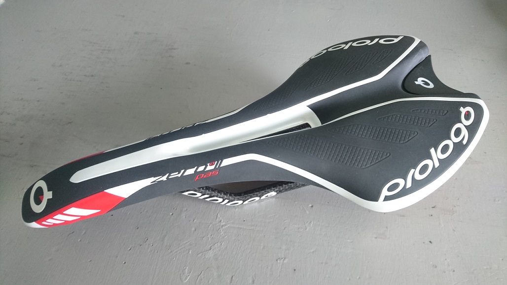

    Decided to get it, here she is for the record:
    Circa 2015-2016 Prologo Zero II PAS Nack

    I hope you have a full length clamp seat post. My Time NXS doesn't and Prologo was a no-go. They don't texture the rails like Fizik and Specialized do, and it makes a huge difference. I had to sell the Prologo and got a Fizik with braided carbon rails. The Prologo slipped with up to 8-Nm of torque on the bolts.
