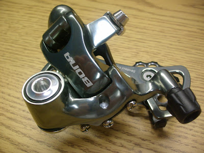

    Initial impressions were favorable. All pieces felt substantial with a nice titanium-like finish. The shifter bodies have a very plastic appearance on the inside, meaning the parts that do all the work don't have the substantial appearance that my old Ultegra levers had. However, the assembly appears to be solid and very well manufactured for a budget-oriented group.
    Installation and Set-up
    I'm not a mechanic, not even close, but the installation of the MicroSHIFT components was straight forward and easily accomplished by anyone with access to a set of metric hex wrenches and a quality set of cable/housing cutters. I am sure I took longer than they guys at my local bike shop could do, but if it meant saving the money and having the experience of doing it myself, it was well worth the time spent.
    The included instructions were very clear, with the occasional grammar issue that sometimes happens in translation. After installing both derailleurs, and levers, the most time-consuming task was installing the cables and housing. After this, I was ready to set it up. Once again, the instructions were very clear and I was able to get the rear derailleur shifting well-enough after just the first step of the adjustment phase. A turn and a half of the adjuster barrel had the derailleur effortlessly moving the chain across the cogs with not a bit of noise or hesitation. Click!...Shift...Click!...Shift. It worked perfectly.
    The front derailleur was a bit of a problem. I couldn't get it to center completely to elimitate chain rub. I attributed this to the fact that I also swapped my 53 x 39T rings to a semi-compact 50 x 30T combination, and due to the braze-on tab on my frame, I couldn't get the front derailleur within the 3mm gap above the big ring that MicroSHIFT recommends. After spending a couple hours, I swapped back to my Ultegra front derailluer and with a little fine-tuning, it shifted very well. The Ultegra front derailleur cage has a much lower profile than the MicroSHIFT one, which eliminated the chain rub due to less surface area.

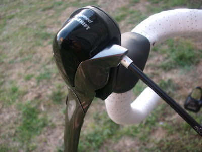

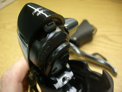

    A good read.
    What about the shifting ergonomics? And is that upshifter as flimsy as it looks?
    Wanna go for a ride?
    Reputation: LandShark'n's Avatar
    Jan 2011
    195
    Quote Originally Posted by kbwh
    Thank you.
    I was concerned because I had read the left-hand, or front shift lever had a very long throw. To me, the throw is longer than the Shimano Ultegra and feels reminiscent of the Campagnolo Veloce group I had at an earlier time. I have small hands, but I didn't find the throw to be exceptionally long or even mildly inconvenient.
    As for the upshift lever, it feels solid. It takes very little movement to actuate it, but it does require a firm push. The resulting shift is crisp and precise with no noticeable play in the lever itself.

    Wow, for something that's not their top end and priced so low, it looks really good. Arsis ironically looks cheap in comparison. Would give this consideration if I wasn't on not-broken-don't-fix terms right now.
    Out of curiosity, how's the spring tension on the RD?
