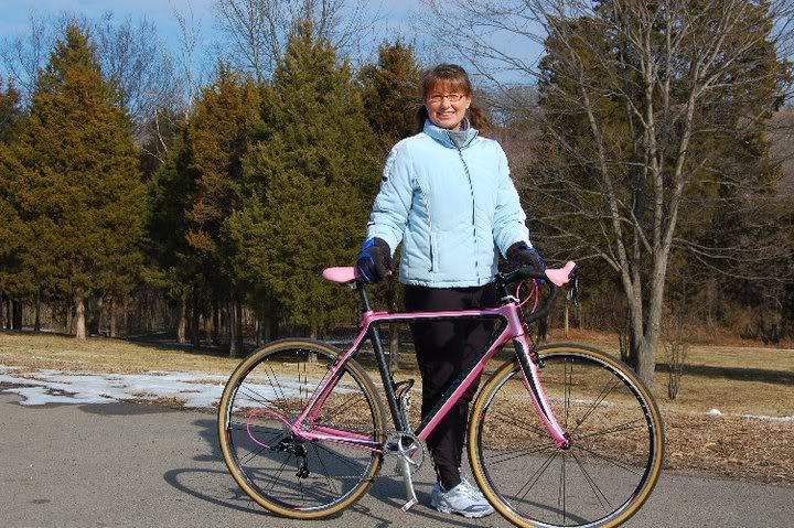

    I built up a Hongfu FM-022 'cross frameset for my wife, who said she was interested in getting into 'cross. She hasn't raced it yet, but I raced it a couple of times last season. It's set up as a 1x10, with SRAM apex 11-32 cassette and RD.
    The bike is light and fast, and gets plenty of notice, partially because of the pink and black custom paint (also done by Hongfu), and partly because people don't recognize the frameset. I don't know if the FM-022 is based on another manufacturer's design or not..

    Here's a pic from her first day on the bike - shortly after Christmas. Don't give me any grief about not having a helmet, she put the helmet on before riding.

    My wife would kill for that bike.

    Nice bike.
    But dang that's a lot of pink cable back there.

    Yes - rear der cable needs to be shortened.
