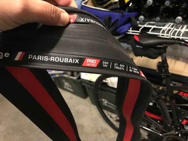

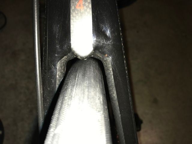

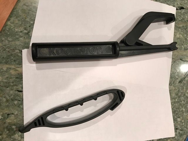

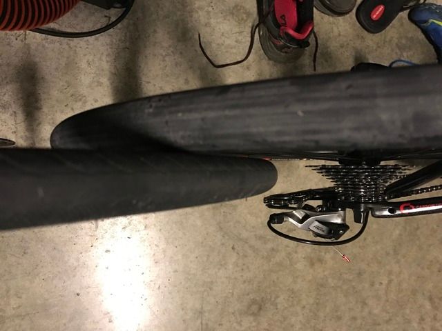

    OK. I purchased the Challenge Paris-Roubaix 300 TPI 27mm Open Tubulars for my Z4 Disc. I just installed them. They fit just fine, at least after initial mounting. Takes about 20 minutes per tire. I now know why Felt doesn't put them on their bikes. They would have to charge $100 more per bike just for the labor. Fortunately, I bought the Crank Brothers Speedier tire lever and the Kool Stop Tire Bead Jack. The CB tool help you get the first bead on the rim. I needed both tools to get the last 6 inches of the second bead on the rim. For now, as Challenge recommends, I am using butyl tubes. I am using 700 x 23/25 tubes for now. I will try the latex tubes after the tires stretch. I have an English Century next weekend on the Eastern Shore of Virginia. If it doesn't get rained out, (the forecast is for an East Coast deluge), I will report back on the ride quality. Just riding in my neighborhood tonight, it feels a bit springier.
    The tires come flat.
    Here is the 25mm Rubino (still a bear to get off the rim)
    This is the Crank Bros tool needed to get the first bead in the rim.
    This is the clearance with the Challenge 27mm tires installed.
    Comparison of the 25mm Rubino on the left (front wheel) and the 27mm Challenge on the right (rear wheel).
    Kool Stop and Crank Bros tools. You can thank me later.
    Update: I did ride the English century on the eastern shore of Virginia. Temps as low as 46, avg 51, briefly got to 61F. 21-25 mph sustained winds, rain, and gusts up to 40 mph. But the Challenge tires were fantastic. Earlier in the week I road 35 miles with the tires at 80 psi. For the century, I filled them to 90 psi. The roads were rural, and there was a fair amount of leaves/twigs and small branches from the high winds. Wet traction was just fine on the very flat route. Obviously, comfort was the most noticeable of these tires, along with great cornering feel. As others have noted, the tires do stretch a bit after riding, and they look larger than 27 mm. The Felt Z4 Disc still has clearance, though only about 2 mm from rear tire to the "rib" that protrudes downward from the rear seat stays. I am planning to get latex tubes and I will update again after I purchase them. Still deciding between Vittoria and Challenge for the latex tubes. Bottom line: if your bike will fit the Challenge Paris-Roubaix open tubulars, you will be impressed with the ride compared to 25 mm tires. I certainly haven't felt any slower with them over the 140 or so miles I have ridden. I will update with their longevity over time. If they last long enough and over time have reasonable puncture resistance, I will stick with these tires. You can find them for about the same price as 28 mm Vittoria G+ Rubinos. But the initial installation is a bear.
    Here is the clearance after 140 miles:
    August 2017 UPDATE: I now have more than 3000 miles on the tires. Front has minimal treadwear. Rear has lost the herringbone tread down the center. Maybe another 500-800 miles left. I will definitely repurchase. And yes, I moved them to Zipp wheels and they are much easier to mount after the first mounting and some miles.
    November 2017 UPDATE: I just passed 4000 miles on the tires. Front tire can definitely go more than another 1000+ miles. Rear tire has held up well and may get me through some winter training, but I will definitely replace for spring training. It is not quite squared off. Local bike shop ordered me 2 more tires and matched ebay prices.
    April 2018 UPDATE: Just passed 5700 miles on the set. I replaced the rear tire due to some cuts in the tread and not wanting to push my luck. I will replace the front tire in a few weeks. I am getting better at mounting the tire with less difficulty and less finger soreness. I am now riding Zipp 30 Course Disc wheels. There is a lot of clearance with newly mounted tires before they stretch.
