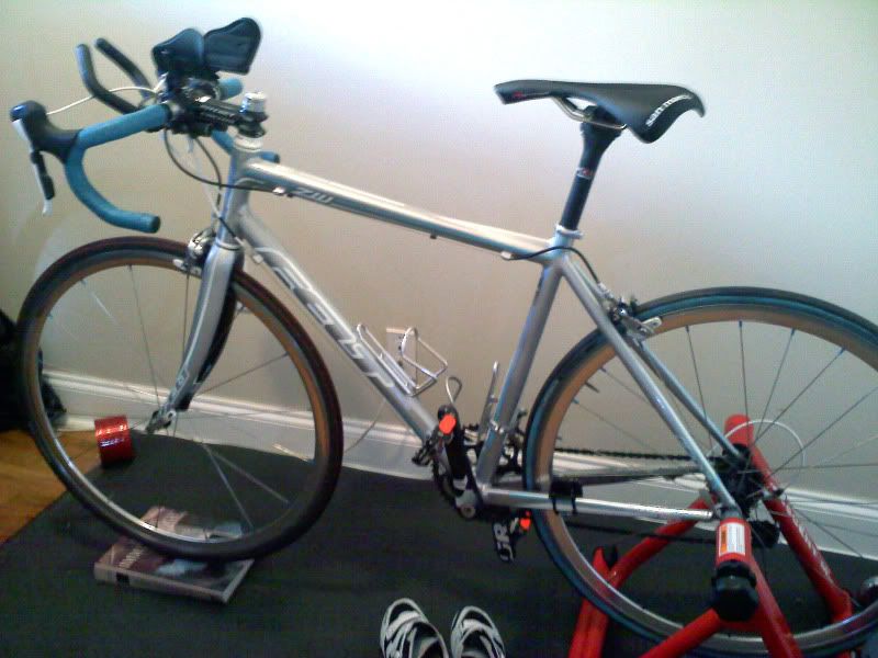

    On my fiancee's ZW95, we also made many upgrades. She too wanted to make it easier to go up hills, but before we changed the gearing, we swapped out the crank and wheels, which dropped a substantial amount of weight. She no longer had trouble getting up the climbs! If she does run into trouble down the road, we'll also go the route of cassette changes rather than a triple.
    The reason we swapped cranks was because the stock crank shifted horribly and kept letting the chain get stuck between the rings, usually at the bottom of a steep climb. We've put quite a bit into the bike, but the frame is light and responsive, so I feel it's worth it to upgrade. I built the wheels myself using Kinlin 30mm rims and hubs from bikehubstore.com; they were my first set and, even with the truing stand, they cost under $400 and come in at around 1475 grams. The seat, post, stem, and aerobars were all added for fitting purposes (but why not save some weight at the same time?)
