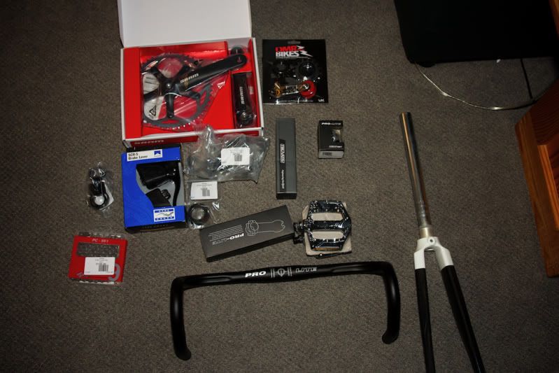

    Next was a big order from Chain Reaction. To stay under budget, I scoured their site for deals, clearance items and discounts, also using a "customer appreciation" discount code that I got from a previous order. Managed to get all of these parts for under $500, achieving my budget goals - including the wheelset!! Speaking of wheels, I decided to go with a standard road wheelset/rear hub, along with a SS conversion kit (spaces and a single cog). That way, if I ever wanted to add a geared drivetrain in the future, I wouldn't have to buy another wheelset. The Specialized saddle was donated free from a friend
    The list included:
    - SRAM S100 46T crankset
    - Truative splinedrive BB
    - SRAM chain
    - Pro-Lite integrated headset, 110mm stem, and ergo bars
    - Crane Creek Brake levers
    - Tektro road brakes
    - Vitus carbon fork
    - Shimano r500 wheelset

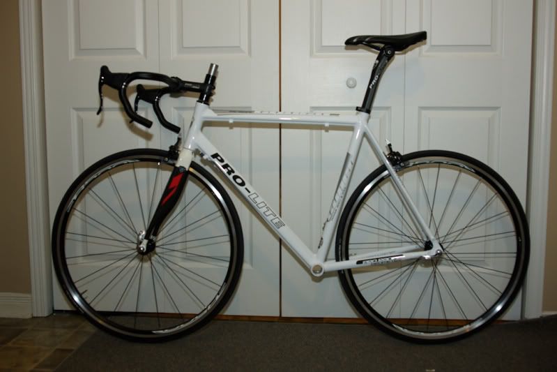

    I built a mockup to take some measurements for steering tube length, bar/stem position, and brake lever placement. Here's what it looks like so far:
    I'm still waiting on the anti-seize for the BB, so I haven't done any drivetrain work yet. Also need to buy bar tape and cables/housings for the brakes. The only thing I will have the LBS do (because I don't trust myself yet) is to cut the steerer tube and press in the star nut.
    Just got 20cm of snow last night, so this is definitely a work in progress job. Won't be riding it till the spring, but I'm very anxious to try it out.

    The parts list were highlights - there were other small parts that I didn't list, but are in the picture. The tensioner kit is there (upper right in the goodies picture) - I plan on seeing what the chain tension is like without it. I'll use the tensioner if I need it.

    Another update. Made a trip to the LBS to get my fork steerer cut and start nut pressed in. While waiting, I picked up some brake cables, jagwire housings, and axiom cork bar tape.
    When back home and built up the headset, wired the brakes, and wrapped the bars. I was a little nervous about the wrapping, but I think it turned out very well for a first shot. Only thing left is the drive train. Still waiting for some final tools for BB assembly and chain installation.

    Well, its finally done.
    Sorry for the crap picture, just a quick snapshot.
    I ended up using the chain tensioner kit. I was having problems getting the proper chain tension while keeping the rear axle seated in the dropout. As I got towards good tension on the chain, the axle would start lifting out of the dropout. I don't think the tensioner looks all that bad - although I'm sure the diehard SS/FG enthusiasts will disagree.

    I've ordered a 1/2 link to see if I can reduce the signature, or remove completely, the STS tensioner. We'll see how that works.

    I didn't want to hack the frame at all, in case in the future I wanted to convert it back to a geared road bike.
    Jul 2010
    791
    Final little touch - added a half link to tighten up the chain a bit. Ended up still needing the tensioner, but was able to use the "push up" method which is preferable.
