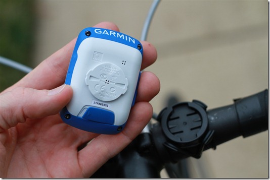

    Reputation: dudigrinfeld's Avatar
    Aug 2010
    354
    Garmin edge 500 mounting problem
    Here how my problem looks like
    Garmin edge 500 mounting problem-imageuploadedbytapatalk1371217528.577396.jpgGarmin edge 500 mounting problem-imageuploadedbytapatalk1371217538.893213.jpgGarmin edge 500 mounting problem-imageuploadedbytapatalk1371217551.500929.jpgGarmin edge 500 mounting problem-imageuploadedbytapatalk1371217570.579897.jpg

    Reputation: Cyclo-phile's Avatar
    Sep 2005
    2,527
    Looks like both of your mounting tabs have broken off of the back of the computer.
    Aug 2010
    354
    Exactly do garmin provide replacement for this back panel?

    Reputation: nOOky's Avatar
    Mar 2009
    8,324
    Yep, but it will cost you and you'll be out the 500 for a while. Best to contact Garmin and get the process going asap.
    Dec 2006
    913
    My tabs broke as pictured, and I was able to retrieve the tabs. I ended up super-gluing the tabs back onto the computer, and very, very carefully attached the computer to my K-Edge mount. As was suggested by a previous post, I just detached the K-Edge mounting arm from the clamp when I had to remove the computer. I'll admit, it was a bit of a pain, but held securely.
