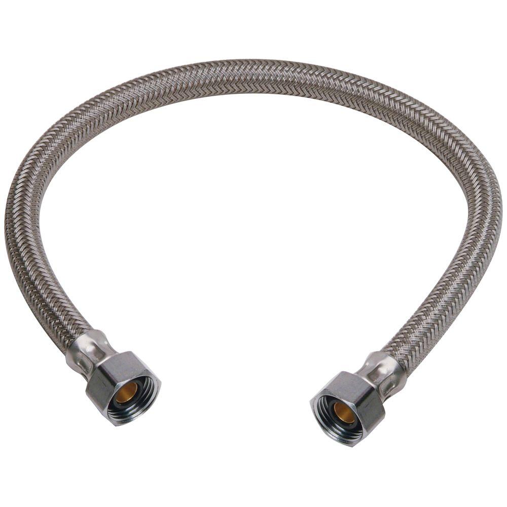

    You should not need teflon tape on this install. A plumber told me he always uses two wax rings per install, I tried it and it works great, Use one premium one with the rubber skirt and one bare bones type on top. If the wax isn't pliable enough a couple secs in the Microwave does wonders. Is that plaster on the floor or is it maybe drywall mud, Scrape/chisel it off with a painters 5 in one tool. Make sure your flange bolts are stainless steel and make sure they aren't too long or the caps wont snug up. Make sure you replace the supply line, you are asking for an unfixable drip if you don't.
    The teflon tape is for the supply lines.
    The connection at the valve should be a compression fitting (3/8) and the one on the tank should have a rubber gasket. You don't ordinarily use teflon tape on either connection. There is the rare time when a compression connection at the valve has an annoying drip when tightened securely. Sometimes a single wrap of teflon will stop the drip, but compression fittings are designed differently than pipe thread fittings. The connection at the tank should be tightened by hand and then maybe a quarter turn with a pliers. Turn on the supply and tighten a quarter turn till no leak is present. Teflon tape is for NPT pipe threads.
    Mine are not compression fittings, 1/2 threaded. Guess it just depends on who did the plumbing before me. Have 3 1/4 turn ball valves I'll be replacing the original ones with that so have compression fittings since I did not want to use adapters on the faucet setup I have once we are done tiling and installing the vanity.
    I don't think I've seen a toilet supply valve that wasn't either 1/2" by 3/8" comp or 1/2" by 1/2" comp and the latter is rare around these parts. 1/4 turn ball valves are the way to go esp. in areas that have hard water. Not many things worse than a balky toilet supply valve when the toilet is over running the bowl.
    It's a screwy setup, this is basically what I have (except the valve is straight through not right angle). My guess, they just dumped the compression ring and nut, and connected the line directly. I have no idea why, and the valve does not close completely, fortunately I sweated in 2 ball valves inline in the utility room to shut off water to the second floor altogether when I redid the well plumbing. That is another major project. I used CPVC to replace the rusty galvanized piping because I was being cheap, and copper is ridiculously expensive, so to save some cost (as we are paying two mortgages at the moment) I went with cpvc piping and replaced the pressure tank connections (the T on that with a pressure gauge and blowoff valve were a small fortune). But the pipes stick out a little due to their location, and that is also the laundry room... I can just see my kid or wife carrying a giant basket of laundry whacking and breaking the pipes and water going everywhere.....
    That looks like a 1/2" NPT X 3/8" (OR 1/2") Comp supply valve. The supply line looks like a 3/8" comp X 3/8" comp. Stool supply lines have a different fitting on one end. For some reason I can't cut and paste image.
    I just completed a valve addition job in my kitchen last week. I bought one of those valves. They are either 1/2" or 3/8" brass fit thread labeled as "FIP" at the incoming side and 3/8" outside diameter compression thread at the output side. Those 2 threads have different spacing. You have to make sure the existing supply pipe thread is compatible.
