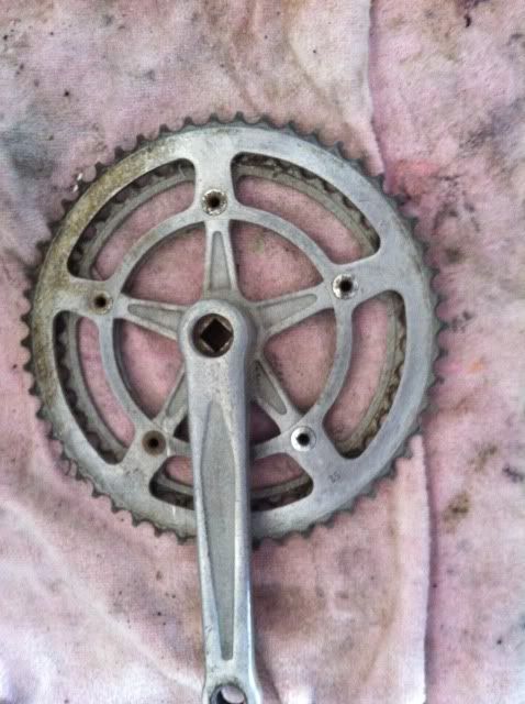

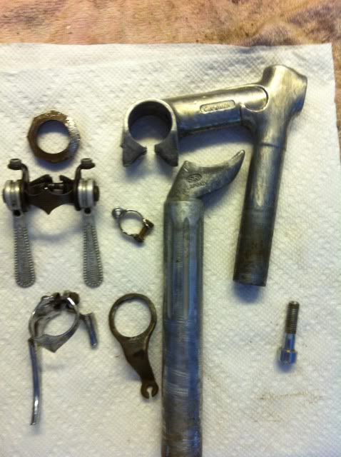

    Some components from the bike I'm thinking of using. The stem is kind of beat up but definitely usable with the carnielli panto. Downtube shifters are smooth and cable router is in good shape. The crank has this greenish corrosion but no pitting and the teeth are good.
    Pretty much just brushed the stuff off, is there any chemical cleaners that will clean up the surface? Not looking for a perfect restore just want to get it in decent rideable shape.
