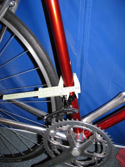

    I've decided to build the 979 with DA 7800 parts. I need a clamp-on style front derailleur.. Is the correct clamp size 28.6?

    Quote Originally Posted by hawker12 View Post
    Yes.

    Well it seems that finding a 28.6 DA derailleur is not going to be easy.
    I've been looking at the Shimano Derailleur adapters that will allow me to use a braze-on model but can't find any evidence that Shimano makes one in that size. Anyone?

    Just get the braze on one, and get a clamp off of ebay. In a worst case scenario, you'll have to use shims.
