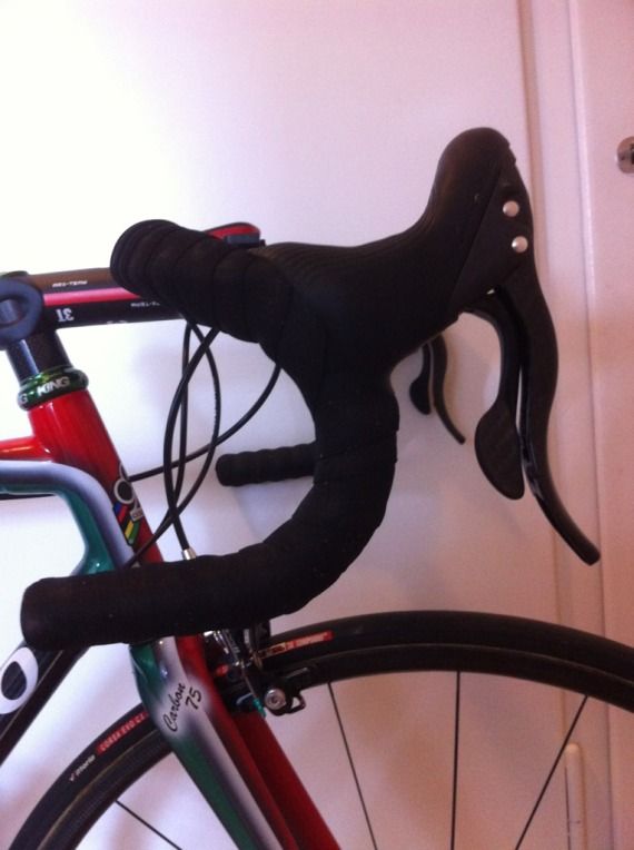

    Very nice, but you mounted wrong the ergos.
    On classic bend handlebars is better to align the brake lever tips with the imaginary line prolonging the drops.
    Then set your drops parallel to the ground, the ergos will be then perpendicular to the floor and in the right position.

    yeah, I hear you on the looks part of it Salsa_Lover,
    I have been playing with the bars and levers a bit trying to find a position I like. Classic bends may ultimately not be for me.
    I like (or am used to) having the entire top of my cockpit all being flat and level, and at the height of the stem. I have pretty big hands and like to use the tops of the bars as one giant extension of the hoods. I can almost have the heel of my palms on the tops with my fingers on the levers. The curve of the bar top supports the edge of my hand, and I can stay there forever without any pressure on the middle of my palm or thumb.
    Having the bar slope down into the hoods with steep ramps really limits my usable real-estate and adds more pressure to the center of my hands.

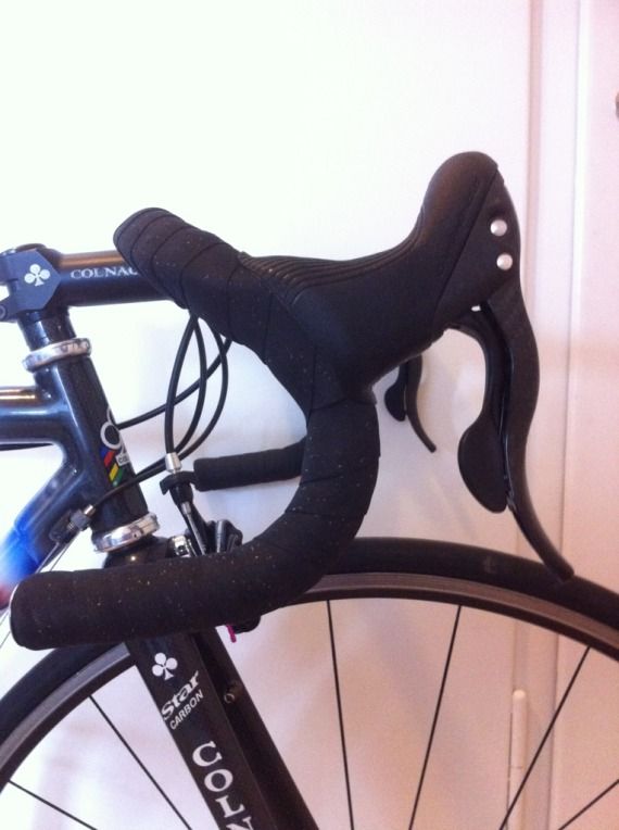

    This is how I run my 3T Ergonovas

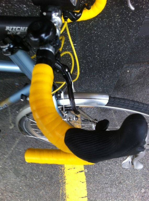

    See for example a classic bar on this C40, ( this is an ITM )
    or this on my Commuter bike ( this is a 3TTT TDF )
    In that way you have tops that are higher than the hoods, and you have the ramps that give you several useful and usable down positions and different widhts and heights, traveling along the curved surface.
    Same concept as the curved hooks where you also have a continous surface to find where is the perfect spot to place your hands.
    Even though I give you that point, they are less comfortable compared to modern bars..... initially.... once you get used to the classic bars, you will find they are much better.
    I have them on all my road bikes, but I have settled with the more modern 3T Rotundo that has similar design but a bit less pronounced slope on the ramps.
