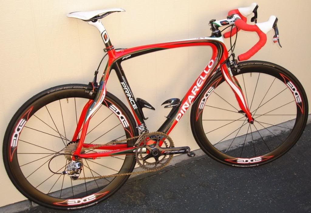

I just switched out my SRAM Red crankset for the new Fulcrum Racing Torq RRS crankset so I thought I'd share my experience with anyone interested.
Objective: Increase stiffness and lose a little weight in the drivetrain.
Tech: Both cranksets utilize multi-directional C/F hollow tech crank arms with outboard bottom bracket cups using high grade ceramic bearings. The new Fulcrum RRS crankset is the same spec as the the 09 Campy Super Record Ultra Torque with CULT Technology ceramic bearings. Both cranks include high efficiency Hard-Ox anodisation treatment for the chainrings. I opted for the Campy Super Record BB cups because they are hard anodized which give them a nice steathy black finish.
Weight: (Crankset & BB cups/berrings)
SRAM Red - Claimed: 756 grams / Actual: 757 grams (175mm)
Fulcrum RRS - Claimed: 696 grams / Actual: 694 grams (175mm)
Results: Noticably stiffer, lighter (-63grams) with smooth shifting from ring to ring.
Pix below.
:thumbsup:

Not to rain on your parade but no human on the planet is sensitive enough to detect the minute differences in the stiffness between two very high end cranks. Especially since the Red and the Record crank are virtually the same in terms of stiffness according to Fairwheel bikes excellent crank test. It's all in your head....
Though the Fulcrum is a superior crank. Cranks and front derailleurs are the weak link in the Sram product line.
Congratulations, that's a nice crank. The black chainrings look superb!

You totally contradict yourself in your post... and yes, I am human and I can definitely detect the "minute differences in the stiffness between two very high end cranks". I have 2 Pinarello Princes, one with 08 Record 10 and the other with Sram Red. The 1st thing I "detected" on the Sram equipped bike was that it felt noticeably "softer" in the crank/bb compared to the ultra torque crank/bb.
That is why I upgraded to the Fulcrum RRS. Now the Red bike is on par and race ready :thumbsup:

2 Princes...nice.

Wow, nice steeds.

The Fulcrum is a superior crank in that it's chainrings are better, and the ultra-torque attachment system is less prone to failure than the Sram system. Lower Q factor too.
Honestly, machines don't lie and there is the Red crank is actually stiffer under controlled circumstances than the Record.
http://www.fairwheelbikes.com/forum/viewtopic.php?f=77&t=5468
Doesn't mean I'm mocking you, just saying that the 1,000 of a millimeter difference in deflection is not possible for a human to perceive.

Great comparison. I'm not questioning your theory either. You're entitled to your opinion. I'm just a humble cyclist reporting here that in my very un-scientific seat of the pants comparison between my Record10 equipped Pinarello Prince and my Sram Red equipped Prince; the one noticeable difference was in crank/bb stiffness. That's my opinion based on 30+ years of racing/training (40 years on the road if you count my paper route :p)
This ain't rocket science. I don't need an advanced degree in quantum physics to know what works for me. IMHO YMMV

Needs white hoods.
What it really needs is more HP :idea:

I believe it's the Fulcrum's superior chain rings that make a difference. Several people I know have had problems with Red chain rings being too flexible. Even went as far as getting SRAM to send thicker rings to solve the issue. Besides that, both cranks are very nice. I would say the ceramic bearings run smoother in the Fulcrums as well. IMHO
