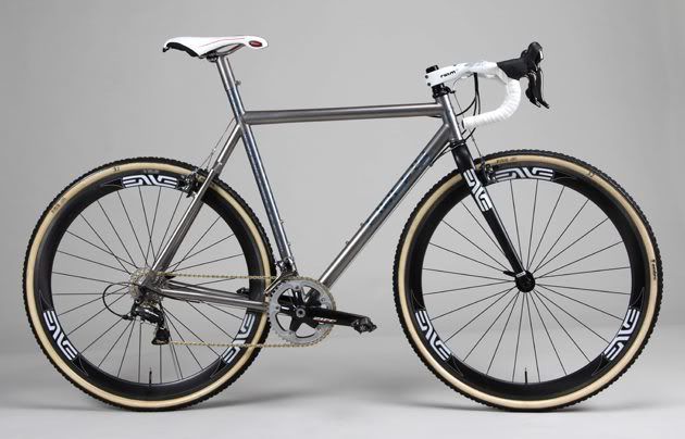

    I feel if I go with ENVE's I would need disc brakes since I have been told rim brakes stink with carbon fiber rims.
    No longer the case. Modern carbon rims give up very little to aluminum when it comes to braking, except in the wet. Even then, with good pads they are still function well enough, mine can still cause my wheels to lock, though with far more effort. The big downside to carbon at this point is the inability of carbon clinchers do deal with extreme braking heat due to long descents or repeated hard stops. If you live in a more or less flat area this should not be a concern at all.

    A couple of thoughts: at 190 lbs, I'd say you can't go wrong with the Axiom SL; not sure there is any advantage to the SLX. With respect to disc brakes, go for it. Remember you are buying a classic frame that should last you a long long time; if disc brakes aren't quite "there" yet, they will be before you want to replace the frame. Same story goes with groupset - I would recommend you have the frame made Di2/EPS ready, even if you start mechanical.
