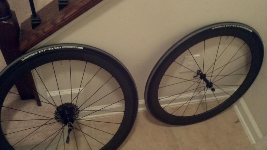

    Got everything mounted up on my Yoeleo wheels. FYI, new Pro4 endurance are hard as crap to mount. I've been very very impressed with the wheels, bearings are super smooth and spin forever. Very light (don't have a precise scale so didn't weigh), and are very very stiff. I haven't seen any defects in the carbon, and the matt 3k carbon looks great.
    I had Neuvation wheels before these, and I have to say, I think Yoeleo wheels are a step up. They seem really well put together. I would definitely recommend them, they've had excellent customer service as well. Even sending me a carbon bottle cage since they didn't do SAT to my wheels, I didn't even want it, but Leo insisted.
    Here are some pics, finally got my 10 posts (sorry I didn't take more or better ones, but at least I took a few!):
