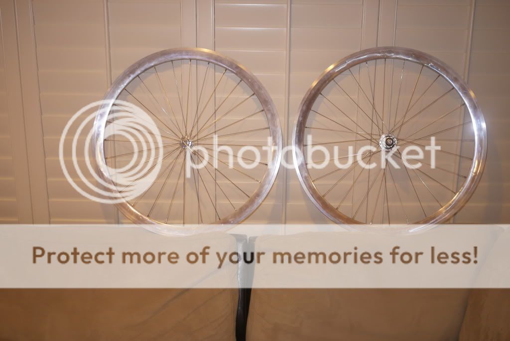

    update on this build:
    Finished building this wheelset last night.
    kinlin XR-380 rims, 28/28
    BHS wide flange front hub/BHS 211 Rear hub
    Radial front, 2x rear w/ sapim lasers and brass poly-ax nipples.
    and the Ti skewers BHS sells are VERY nice. very cool looking, lightweight, and a good deal for the quality imo.
    The XR380's only come in black, so i had to strip the anodizing with lye and some steel wool. Then I polished them by hand to a shine. They look dirty because they ARE dirty--greasy nipple greasing fingers + polished aluminum looks like that. Mostly used Steve Litt's excellent web page, and Mike T's tips to do the wheel build. the front was easy enough to lace up, tighten, and true. Lacing the rear wasn't as difficult as i expected, once i started doing it. What was difficult for me with the rear was getting enough dish before starting to tighten. 1 extra revolution on the DS spokes wasn't enough--i tried to add some extra spins later, and snapped a few spokes in the process. i'm glad i ordered extras. eventually, 2 extra revolutions worked for me, and i think i did a decent job truing.
    anyway, it was pretty intensive, and not exactly easy--but i found that it wasn't nearly as intimidating as i thought it would be. we'll see how they ride!

    Hello Charlox5, I really like your results with these rims, i am trying to get the same, but it is hard to find a good paint stripper. You said you used lye, can you tell me what brand you used or how to create that?
    Thanks much in advance!

    H Plus Son Archetype has a chrome wheel, no extra work needed stripping it.

    Polished silver not chrome.

    Since he posted the pics more than 5 years ago, you should ask if the wheels stood up.......
