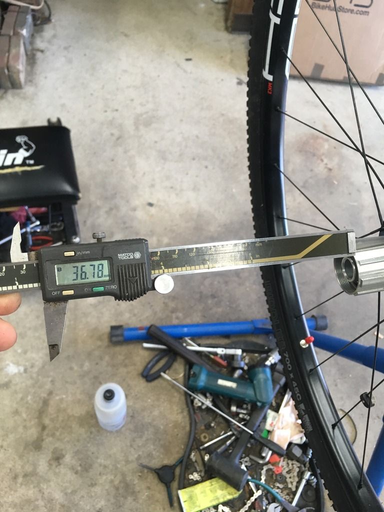

    I just measured my Pro4 and RS4 Rear Freehubs and end caps. I have run 11 speed Ultegra cassette on both with no spacer and no issue. I did not have Mono RS hub on hand but I would expect about the same measurements.
    THe Cassette body plunged measurement is 36.78mm and the Skewer end cap measured 13.20.
