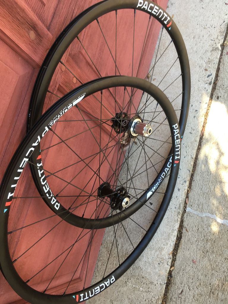

    Built up Forza OSB Disc Rims today purchased from BikeHubStore. BikeHubStore.com
    RIms Seemed every bit as good as the SL-25 rim. THe offset is a nice feature. Rim was very robust and never needed to be chased around, even when tensions got close to 120kgf. The seam where the halves were welded was especialy clean inside the rim cavity. No big crimp marks or staking holes. Absolutely NO bulging or deformation around spoke holes. I might have to consider trying the rim brake version. Very pleased with the change.
  20. #120

    Thanks for posting, I'm considering the exact same wheel build and curious to know why you did a 2-cross lacing pattern instead of 3-cross.
    -S

    Quote Originally Posted by Enoch562 View Post
    Draggin this back to the top...
    Nice hoops!
    How's the finish on those Forzas? Pacenti switch to painting their graphics on rather than stickers?...granted I liked the stickers since they were really easy to pull off.

    Quote Originally Posted by SHIF View Post
    -S
    With a 24/28 spokes, saw no reason for 3x on rear. Nothing to gain.
    The finish is very nice on these rims. Still using stickers. I think this may be some of the best rims Pacenti has offered.
    -S
    From what I can see, those wheels are 24 spoke front/28 spoke rear.
    For a 24 spoke wheel, 2x is the maximum you can do without crossing a spoke over another spoke head at the hub. This is something you don't want to do.
    For a 28 spoke wheel, while 3x is preferred according to Roger Musson's wheelbuilding book, 2x is also perfectly acceptable. This is probably more aesthetics than anything else.
