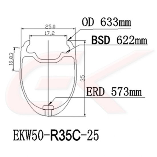

    It's the BSD... because it's shallow and there's no center channel to drop the bead into. Those look like a nightmare to mount.
    Well, that graphic you have shows the BSD to be exactly the 622mm that is common to ALL 700c clinchers. now, if for some reason, they decided to make their BCD an extra mm or 2, that would be a b!tch, but then, a common 700c tire wouldn't really seat without stretching.
