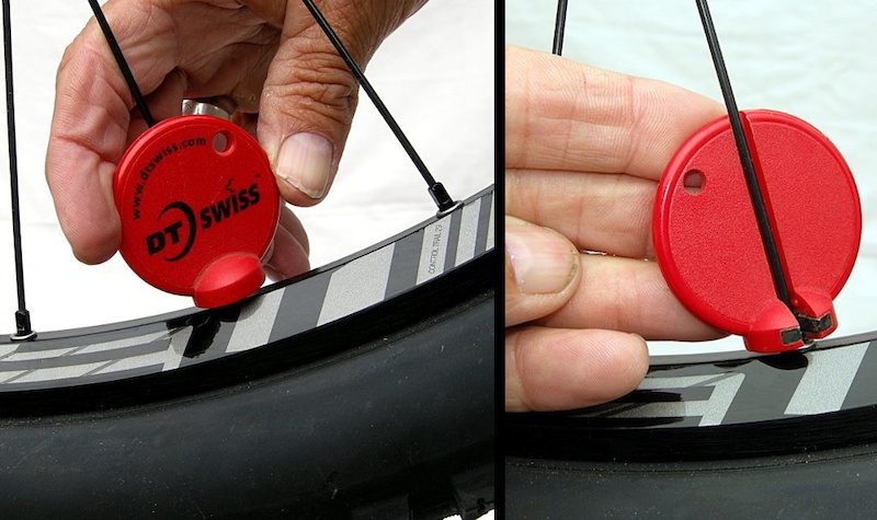

    I like my Spokey.
    Grabs 3 corners/4 sides. Very comfy in the hand and easy to use.
    Spokey Red Spoke Wrench (Pro Version) - harriscyclery.net

    I love the DT Spokey as well.

    +1 Spokey Pro

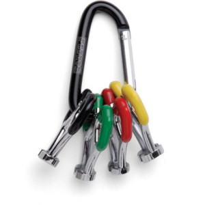

    Reputation: Salsa_Lover's Avatar
    Jul 2008
    4,655
    I use the Pedro's
    several sizes avaliable
    I have the green one and the yellow ( for mavic ksyriums)
