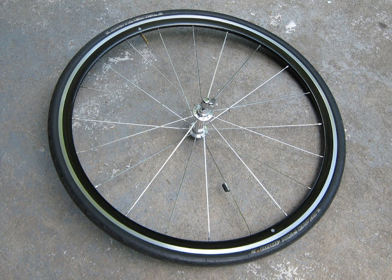

    Here are pictures of a set of wheels Ron Ruff built for me in 2007 using polished WI hubs and black CXray spokes with Kinlin 300 rims. WI hubs are great and these are still going strong.
    Attached Thumbnails Attached Thumbnails White Industries H2/H3, build thoughts?-wi_nio30_18f_cxr_jun07.jpg   White Industries H2/H3, build thoughts?-wi_nio30_24r1_cxr_jun07.jpg   White Industries H2/H3, build thoughts?-wi_nio30_24r2_cxr_jun07.jpg
