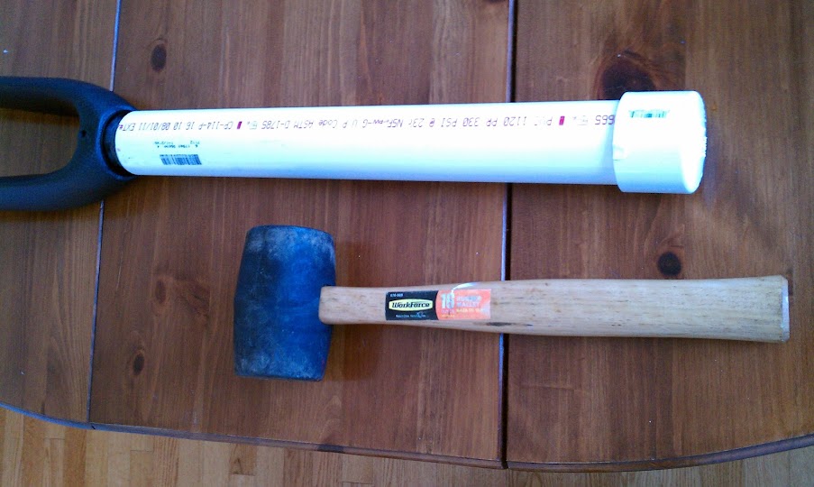

    I made good progress today in my build. First I used a piece of PVC to mount the crown race:
    This worked well.
    I cut the steerer, mounted the fork and most of the componentry down in my basement laboratory. I didn't get to the drivetrain cables before dinner:
    Please disregard the positioning of everything (levers too low, too many spacers, saddle...everything), I have a lot of work to go with adjusting. I'll do that slowly as the riding season picks up here in Chicago.
    The cockpit of this bike is a feast of (Chinese) carbon:
    I had the go to the bike store to get new front and rear caliper bolts and cage bolts. All were given to me for free and worked perfectly. I bought a couple new cages just to compensate them. I love the service a good LBS provides.
    I think this is going to come it at right around 16.7 lbs which isn't bad at all given the full Ultegra and 1,650g wheels.
    No surprises in this build yet. The headset was easy to mount and nice and snug, the bottom bracket shell looks faced and true, the brake cables went in without a problem. I have to say the engineering I'm seeing in this frame exceeds my expectation. This is not the cheap-o flimsy crap I was concerned about.

    Oct 2007
    This worked well.
    Just to comment on this so others don't make a similar mistake, please be sure that you are not setting the fork down on the dropouts when using the mallet to set the crown race. A better, safer way would be to simply turn the entire setup upside down and slam the PVC down against the concrete. This will put all of the pressure to the crown race and PVC rather than hammering down against your fork dropouts, which is a good way to cause serious damage.
