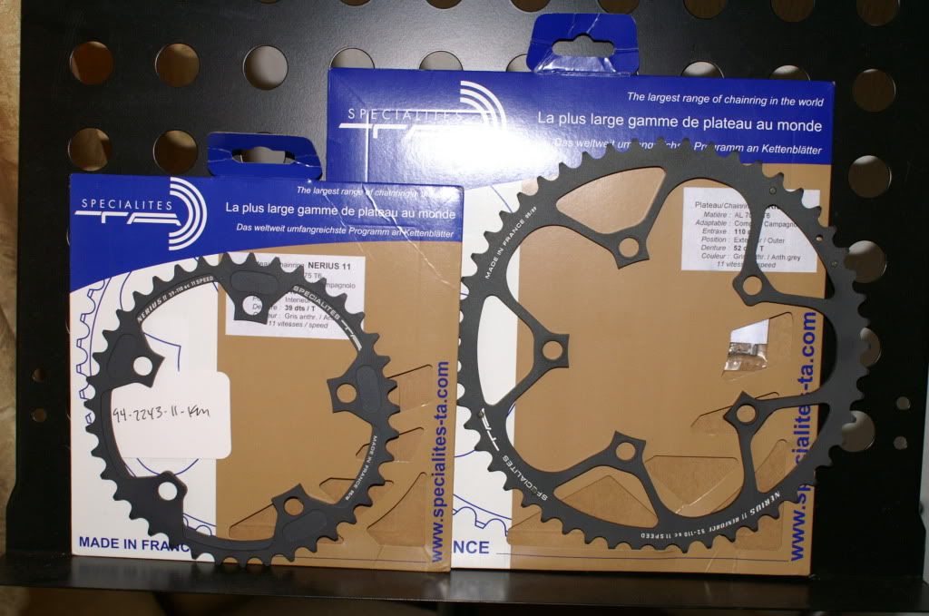

    Specialites TA Nerius 11speed
    I have a set
    can be got from several online shops
    or the Stronglight CT2 Type D seem also to be quite good
    at xxcycle.com
    https://xxcycle.com/110-ct2-outer-11...agnolo,,en.php

    Thanks guys for the information.
    Actually, I am not planning for 11 speeds upgrade, just want to replace the chainrings due to the coating is badly peeled.
    I know the 11 speeds crank will work with 10 speeds, just want to make sure that just rings will work too. Getting the 11 speeds rings will make sure that I won't get a set of replacement rings that will have the same problem again.

    the Nerius 10 speed rings are very nice indeed, they come on a polished silver finish nicer than the original ones. check them out.
