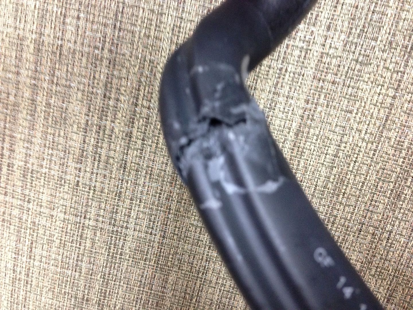

    Quote Originally Posted by nhluhr View Post
    Must be some new form of carbon that looks like alloy...hmmmm.....
    I've had carbon on both my road bikes. I've had a few spills and they have been fine for the most part. I did crash in a crit a month or so back and the bar didn't crack but where the bar plug goes got shredded a bit. The same thing would have happened to an alloy bar the only difference is that this crack may spread. That crash was at 30mph though so it was at speed.

    Quote Originally Posted by deviousalex View Post
    Well yeah, it's obviously carbon since it is broken.
    I'm going to start making solid-core steel bars. I think there's a market to sell them on this forum.
    Here is the difference, MY friend did the same thing you did - crashed on his carbon bars, and while there were a few scratches near the bar plug everything seemed fine, right up until he hit a pot hole at about 10 mphs (i.e. not that hard) and the bars failed completely at the stem dropping him on his face.
    Mind you my friend is an experience bike mechanic and works in the cycling industry, meaning he fully examined the bars and even tested them a bit but leaning on them, the bars exhibited no damage or weakness prior to failing. These were not Chinese knock off btw they were from a major manufacturer.
    Now I don't think they will happen to every set of carbon bars but seeing as any fall usually hits the bars and pretty hard its not a risk I think even worth taking considering that carbon bars offer no advantage and I have never seen alloy fail like that.
    That one incident prompted me to sell my carbon bars, no way did I want to wonder if my bars were going to hold u post crash esp if I was going back into a crit from the pits.

    Quote Originally Posted by 32and3cross View Post
    I've taken a spill with carbon bars multiple times (fast and slow), on one occasion I wore through my brand new bar tape (some scuffs on the end of the bar), the bars are still in 100% working order.
    Each accident is a unique event, both alu and carbon can/will fail, carbon may mask a failure better.
    If your friend had fully examined the bars the damage would have been found.
    There is no way the crack wasn't there. That just isn't the way carbon fails. Did you pull the stem face to check? Was this all the same ride?
