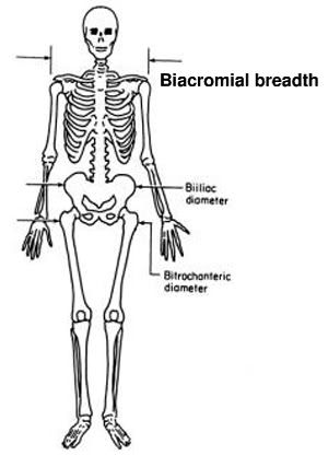

    No hearsay or guessing, facts about shoulder widths in males.
    5% is people on the small side
    50% is general Population
    95% is people on the large side
    Chart is for males in the US from 1999
    As you can see from the charts most men should be on 42cm maybe 44cm bars based on shoulder width. Or you can just goes with what feels best to you and be ok with that.
