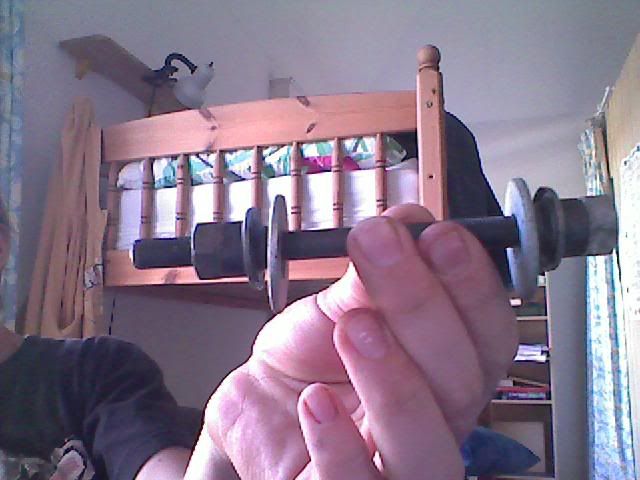

    Can anyone recommend a bearing press for home use? I don't want a POS cheapo one -- but I also don't need a bike shop version. The bearings required are two 6901-2rs and four 6802-2rs. Looks like they total around $60.
    Any other tips on rebuilding these hubs are appreciated.

    Did this for a friend. There are pics on the White industries site. They said you could use a socket to knock out the bearings and it worked just fine - no press needed. Also used to press them in - just be sure the socket presses on the outer race. And be sure to follow instructions with the set screws.

    Google "homemade bearing press" for examples of, um, homemade bearing presses; they all kinda look like this:
    You mentioned you didn't want a POS cheapo one, so this can be your standard of rejection, but it works. As steelbikerider said, carefully (ask me how I know) tapping out the bearing gets 'em out--my old Suntour "bearing tool," from the dawn of sealed bearings, is basically just that, a thing to tap out bearings. (Suntour also included things to tap new bearings back into the hub, but this is a bad idea--pressing them in is better.
    Re non-POS/homebuilt tools, Amazon has some options that aren't too expensive. I thought the Boca Bearing tool looked pretty good.

    So just use a socket wrench that presses against the outer edge of the cartridge?

    I am going to try doing this myself in the future. Looks like I can get the bearing cartridges for $60 for both wheels.
