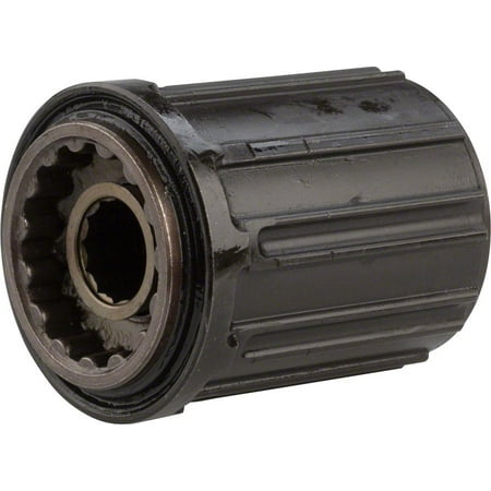

    Question Are these hub bodies interchangeable?
    Hi folks,
    I think the answer is probably no however wanted to make sure before I go out and get all the tools for this. I have a Shimano RS11 Rear Wheel that I am going to use as a trainer for my wheel-on smart trainer. I have a Campy equipped bike that I am going to be training with. Someone gave me a PowerTap Campy Hub and want to see if I can swap the Shimano hub out for the Campy one.
    I have attached pictures, any help would be greatly appreciated. Thank you everyone.
    Attached Images Attached Images
    Sep 2011
    668
    Not going to work. You'll need to get a Powertap Shimano freehub body.

    Quote Originally Posted by tinof View Post
    Hi folks,
    I have no specific information about these particular hubs. You don't even give a model name for the Campy hub. But I can say, without fear of contradiction, that there is virtually no chance that these freehubs are interchangeable. No chance. The only way you can "swap" these hubs is to de-spoke the wheels and rebuild them with the different hubs (and probably new spokes because the lengths would be different).
    Hi folks,
    Impossible to tell from looking at pictures. But likely 99.9999% no.
    The Freehub bearings, ratchet mechanism/pawls, seals have to match the hub. Every Tom, Dick, & Harry have their own ratchet/bearing/seal design.
    The last pic is a Shimano freehub. I assume the RS11 is the same

    I agree, thanks Kerry for the reply. I dont have a model number for the Campy Hub - the packaging simply states Powertap Campagnolo 15mm 11Sp Alloy G3 Freehub Body
    Thanks for the detailed response tlg - really appreciate the time. I am just going to sell the wheel and get a campy hub equipped wheel for my trainer. Enough with trying to toy around
