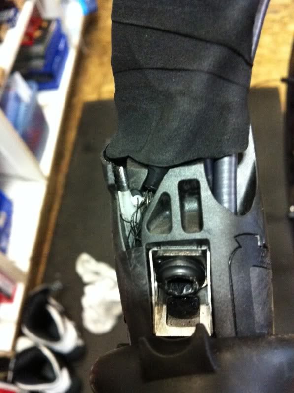

    i figured this would go like this. your position is based on your experience. that's fine. mine is based on working on literally hundreds of bikes a year. yes, i get a unique perspective working on pro team bikes, but that has nothing to do w/ my service advice. i threw that in there because i didn't get where i am today by being a hack teenage lbs mechanic. i take pride in what i do, and i make sure the bikes i sell and service are maintained to the best of my ability because i don't want any of my customers to get stranded out on the road...and it does happen, trust me. "oh, i just had the cables done last year..." says the guy w/ the head of the cable stuck in the shifter and the rest of the cable in his pocket. and that happened today...
    here's the shifter
    here's the shifter
    Ok, so what does a picture prove? It proved the rider of the bike didn't maintain the bike. He should have replaced the cable. None of my cables ever get that bad. But somehow you think all my cables look like that and hence I'm riding a time bomb. Right! And was the lever system checked to make sure something wasn't causing the fraying besides just plain cable wear?
    But in the essence that you have a liability problem with customers then yes, it behooves you to bring into question issues. But to replace a cable that is in perfect shape is all about LBS profits. And you have a lot of customers who don't have a clue how to maintain their bikes that's why they bring them to you, and the excuse of: " I just had my cables replaced last year," is proof that there's a guy who never looked at them and wouldn't know what to look for if he did!!
    So again we're at odds.
    Please don't think I have something against you as a person, for some reason these type of posts always seem to deteriorate to that level of mentality. I don't know you at all and have nothing against you, I've never followed you around from to post to post to cause an argument with you; I'm taking issue with over preventative care that isn't necessary IF, I did capitalize that for emphasis, IF a person knows what their doing with their bikes and use quality cables, then cables should last a while longer then 1 or 2 years.
    When I use to MTB ride I had more problems with cables then on road bikes, and usually I did have to replace those once a year and sometimes sooner. But again, watchful maintenance prevented cable breakage or failure.

    ok, this is sounding a little better. but in your first reply you said cables could last 10yrs. if the bike gets ridden w/ any regularity (and we're on a bike forum, so we expect that) there is no way a cable in a modern shifter will survive that long. that one in the photo is 11mos old, ridden a lot, but not daily as the owner is a mtb racer.
    i said nothing about replacing cables that are in perfect shape, you're saying that. we check them all before we recommend replacing them. i don't know what kind of lbs exeriences you've had, but they seem to have soured you a bit. of course we're in business to make money, but we don't make **** up about our customers bikes so that we can make more money. i just think you should take care when you recommend something to a stranger on the internet that has no idea about bike maintenance. you have obviously had your own personal experience w/ your equipment, and i have had mine. being that i don't just work on my own bike, i see more in a month than you might see in years of your own riding. nothing wrong w/ that, but you have to admit it does limit your view of things that can happen. maybe we should just leave it at this and not bother everyone w/ our differences.
    I'm good with this, I too assume you were saying that you automatically replace perfectly good customers cables every year. This I found to be extreme...especially for road bikes. But now your making more sense and before I wasn't making enough sense. So we have no ill differences, never did.
