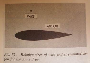

    The way the air flows around his body is quite different than for me, despite the height and weight similarities. He presents a more arrow like shape than I do, which his shoulders enable.
    I was reminded recently by this great 50 year old text book picture to emphasise how air flow around an object has a massive impact to aerodynamics. Both these objects (shown as a cross-section) exhibit the same amount of drag force for a wind coming from the left (or objects moving to the right):
    IOW, it's not just about how much frontal area you present to the wind, but how that wind flows around you.
