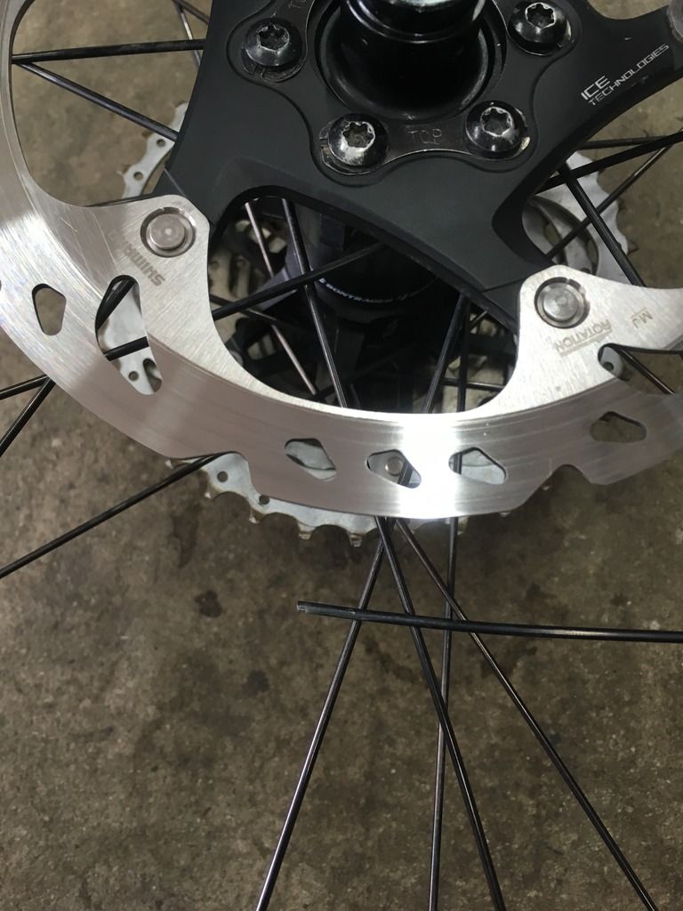

    File under "no good deed goes unpunished." On last night's Thursday night worlds, I notice that the guy who doesn't have the finest hand built wheels in Rhode Island has a wobble in his rear wheel that could seriously make you throw up if you looked at it long enough. Disc bike, no chance the wheel would have fit through rim brakes - reduct the error by half and they still wouldn't have. The wheels came with the bike, the bike is a major brand bike and these are their high end house brand wheels. So I say "hey bring that wheel in tomorrow, I don't want you riding around on that and it's so out I want to check for damage."
    So he brings it in.
    Straight pull, round spokes, internal nipples. It's like the devil had a menage a trois with himself and this is the offspring. Of course I could see none of this as we were riding, otherwise I'd have told him to take it to the shop where he bought it (which is down the street) and they need to make it right. This is a $7000 bike that's almost a year old. Gets ridden maybe 80 miles/week, and none in the winter.
    So I take the whole thing down to zero tension because it's totally messed up, and then a non drive straight pull head comes off at somewhere around 60 kgf (they're 2:1 laced, so nds has fairly good tension). So now I'm an hour into this total b of a job, having just yesterday said there's no way I'd build straight pull round spokes, only since I offered this I'm doing it for free. Shoot me now.
    No good deed goes unpunished.
    I hate straight pull spokes.

    Never volunteer to work on a disaster, of course it is sometimes difficult to determine from outside.
    my other comment was in response to roger-m. If you don't like them, ok, I'm good with one not using them. But to say the whole design is messed up cause somebody somewhere broke a factory made wheel is just wrong. Plenty of J bend spokes have been broken in this world.
